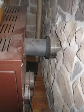

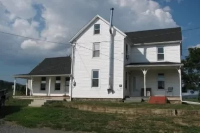

    Thank you! I will post a picture (or try to) to explain better why the rear exit. The current hight of the pipe going through the wall to the outside is 27.5 inches off of the floor. That is the reason for needing the rear exit. :)

    Lots of things going through my mind right now after looking at the pictures..... What is the clearance between the left side of the stove and the window/wall? Are you planning on upgrading /putting in a hearth underneath the stove?

    Just saw the pictures you posted. Yes, the same old Ashley stove. Thankfully ours was not in that bad of shape. In fact another party owns that stove now.
