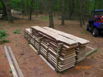

These are Zaps Stack and as good of a job you will ever See!

Zap Stacks- sounds like a new trademark??? Will stacking outside work ok? I have limited indoor storage space at the moment and it would make it much easier if I can keep things outdoors. Will it cause drying problems to have stuff out during a northern Indiana winter?

Like any decking you need a little space between boards, but if you stack like that stack outdoors is fine and even better if covered before winter.
Oh and Zap is a perfectionist! :cheese:
Yes, Zap stacks like we do and it works. Normally though when we cut lumber we'll stack it indoors like in the picture being careful to make sure there is no warpage. Stack it up and forget it for a while. We usually do not coat the ends but if you want to finish it for something like Jay's table, then coating is the way to go.

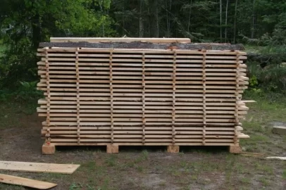

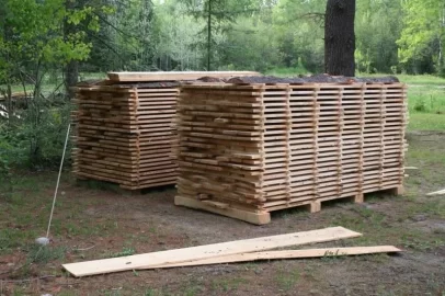

I posted these pics a while back. Don't forget to post yours. :coolsmile:
If you can stack it indoors, go for it. I didn't have that option when we did this stuff, so it went outside on the west side of the house.
Woodmizer with most of the bells and whistles, and no...not mine. May of '08, if my memory serves, and I don't remember ever having worked that hard since I was in my 20's.
I still have one stack left, and it should really go into a kiln to finish. I may build one some day.

Nice work you have a link to the post I think that I missed that one?

Start a new one.....That is a must look! I know I have not seen that stack before.
Dave, that is the right way to stack it. Nice work.

Those are perfecto, great job PapaDave.
