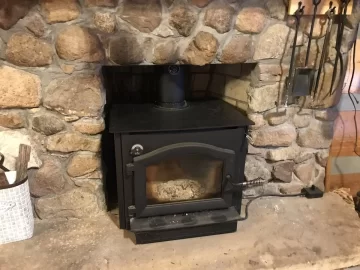

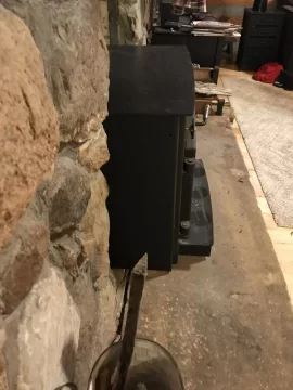

So we have the Kuma Alpine LE. We opted to not install the surround. It has some flexibility as far as depth from the fireplace face for installation. It all depends on where your pipe is. Ours (the box of the stove) sticks out about 7" from the fireplace face. We have the blower on it, but even without the blower running, circulates heat very well. It would do even better without the blower installed, as you would have more space for air to circulate through the air passage.

It looks good without the surround. The more it projects out into the room, the better it will heat without the blower.
