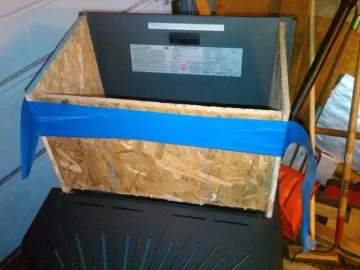

    My friend gave me a great idea! This was his 1st draft! See pic below:
    This would change this 55 lb hopper to atleast a 95 lb hopper!
    Now wait before you say that is wood and combustible, let's think this one out.
    You could use heavy gauge steel and weld the corners. Also have to notch the bottom.
    But that is no longer an easy home project.
    So how about using plywood covered with aluminum flashing?
    Or
    How about Cement Board covered with aluminum flashing for protection against chipping and is fire resistant?
    Now do you have any comments?

    Your lid is used for the back?? What becomes the Lid?
    A hopper fire can happen..... Unless its Lined on BOTH sides, then it wont matter the material.
    Steel is Non combustible. Better to heir on the side of caution. IMO

    We have made a few diff hopper ext. for our own use in our back room at the shop, they have always had a lid and was always made of metal.....Just my two cents for what it is worth :)

    Please use steel.

    Hate to tell you, that is the dumbest thing I've seen on this site. Have a steel one made, what's wrong with you doing something like that? Plywood covered with aluminum siding or cement board with aluminum siding, I can't believe your asking these things.

    I like the one in the picture if you double your insurance:cool: and run. Please use metal.

    Steel and the blessing of a testing lab.

    According to my friend the painter's tape goes all the way around to hold the hopper lid straight up for the back side! LOL
    It may be dumb but it was cheap and works great! Sure steel is the best but I am not a welder and do not have a large welding metal fab shop! !
    Thanks for your comments
    No one is using this extension currently it was just a proof of concept of how easy it can be to make a hopper extension.

    We have even used light weight aluminum as a hopper and pop rivited it togather and used high temp sealant on the edges but again we always made sure it had a lid... To me lid's are important!
