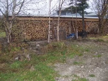

    That shed of Carbon's is a dandy.
    If I were to build a shed strictly for wood, I'd build it long and narrow. I'd also not put the siding up tight but leave about a 2" gap between the boards. That could be done on the sides and on the floor and would allow better air circulation. An old rectangular corn crib works just fine. We once made a corn crib using poles and then fastening snow fence to the poles. We used it for corn a few years and then used it for storing wood. It worked out great. We had a door in the center and there was enough room to store 2 years wood supply; half on one side and half on the other.

  21. bogydave
    bogydave
    Dec 4, 2009
    8,426
    3,447
    So Cent ALASKA
    I don't know if mine is called a "woodshed" , "covered wood pile" or a "roofed wood pile".
    Not having any sides makes it just a cover over the wood.
    To be a woodshed, my thinking, is it needs sides. ??
    I call it a wood shed but more accurate may be "covered stacks of wood"
    Maybe just plain ole "roof" , is even more accurate. As in:
    My wood stacks have a "roof".
    What is the official "Hearth definition" of "wood shed",
    & does it need sides to be one ?
    Mines is a "wood-roof" (not a roof made of wood, but a roof over wood) :)
    [​IMG]
    cptoneleg likes this.
  22. madison
    madison
    Sep 12, 2008
    1,528
    112
    41.33°N 74.18°W and 44.67°N 111.0°W
    Thanks dave, appreciate it, shed, woof, roof as long as it gets the job done.
    Dimensions? looks like two pallets deep by ? Length? And I notice the cross stacking intermittantly throughout, is that for stability, airflow, all of the above. Would you divide the length to add row stabilization? I see cross pieces on each end. Is that approx two yrs of wood ?
    Footings vs slab?
  23. bogydave
    bogydave
    Dec 4, 2009
    8,426
    3,447
    So Cent ALASKA
    Roof is 8'X48'.
    Inside wood is 80" deep, (4 rows) X 8' high X 47' long (+/-)
    Stability, separate wood types
    I also put in some rope from the back row to the front row in the middle of each section for stability
    & safety. When my wood stacks gets this high, they wanted to move some. link:
    https://www.hearth.com/econtent/index.php/forums/viewthread/57345/
    Hoping for it to be 2 yrs worth of wood.
