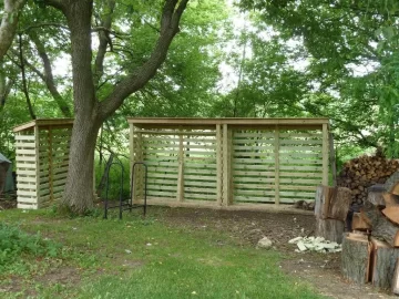

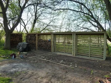

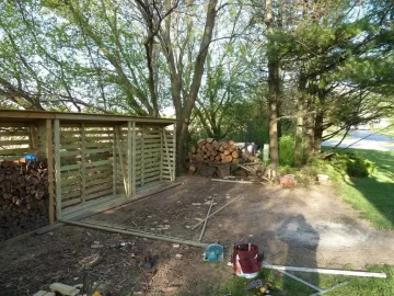

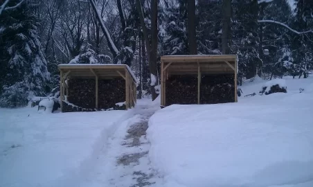

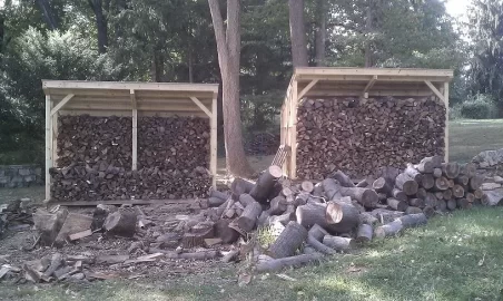

    I designed these racks that each hold 1 1/2 face cord for a total capacity of 7.5 face cords, plus a half face cord rack on our back porch. We average consume 5.5 face cords a season. Though fairly open, the wood stays mostly dry from rain and snow. I have an assembly line type arrangement where I off load large logs from trailer, split, and toss in front of the rack for my wife to stack.

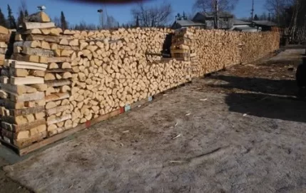

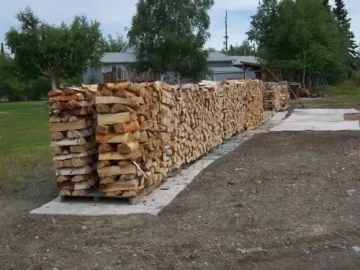

    For seasoning . 1 year here:
    Pallets, double row 4-1/2 ' high, with space between the rows, cross stacked ends & every 16'.
    A place with good air movement (wind), sun helps.

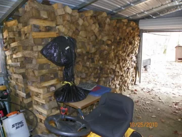

    In the fall I split about 5 cords and leave it 'out' for about a year. Once fall comes I fill the sheds and feed out of there for the winter, replacing the 5 cords on the ground to season until next year.
    NOTE: I keep a rack with about 1/2 cord by the back door to feed the stove from and refill it every several days. I also keep a 1/4 rack next to the stove that ony gets used in extreme weather when we don't want to go outside!

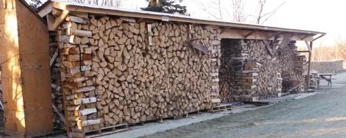

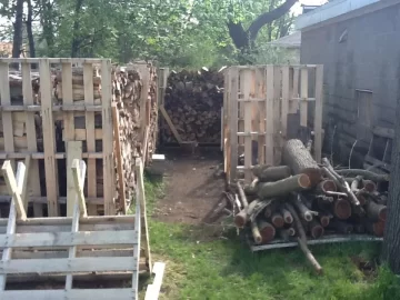

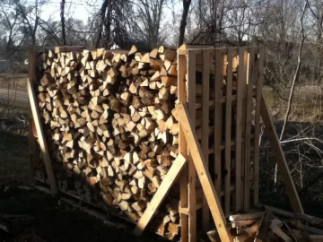

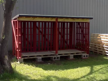

    I use pallets to make bins for drying then move it to a covered wood shed for the winter to burn. Ignore the small spits in the shed that was for our old stove which was smaller.

    That a pretty picture the one with the Snow

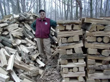

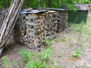

    This is how we stack the wood. Notice in the middle picture some poles leaning on the wood stack. That is what we put under the wood. They are just saplings cut in our woods and they last several years. Also in that middle picture you'll notice the wood is covered with old galvanized roofing. The last picture is wood stacked in the barn to be used over the winter months. Another thing you'll notice is that we use nothing except the wood for the ends, even in the barn.

    That you in the first Pic Sav??

    Yes. I'm the ugly one. Same for the avatar.

    The pallets are 8 ft long however you could lay 4ft pallets and use bolts to connect the middle of them. I get 8ft pallets that our material at work comes on. It is possible to find them at Home Depot as well as Lowe's too they get there paneling on them sometimes. In one 8ft bin I can ft 1.25 full cord ( not face cords ) if I stuff in the middle between the stacks. The center pallet standing upright will mostly hold itself because the wood on each side of it pushing it in place. The end however you will need to use bolts or long polls into the ground. They have held up for a year and are not rotted yet to my surprise.
    Pete
  18. Pallet Pete
    Pallet Pete
    Guest 2.
    I would also recommend painting them with oil based barn and fence paint it is heavy and thick. I painted my wood shed with that paint and it still looks like new after 2.5 years and will last for many more. My fathers swing is also painted with that paint and has lasted 20 years without fading.

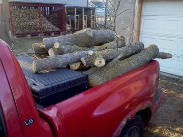

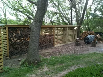

    I don't have any in-process photos. I didn't think about it until we were done with the first three. I drew up a general plan and we built it. Made a few improvements along the way. The photos might give you an idea. My buddy Dan in the photo helped design and build them. My wood storage and working area is in the front yard of my house, so we wanted something that would be visually pleasing, but also easy to get large, cut to length logs unloaded from the trailer and stacked in a staging area for a year prior to splitting. Some of the racks built with pallets would be perfect for that. Great Forum site everyone!

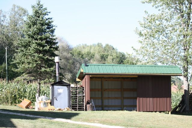

    I like to stack on 4x4 pallets. Two together makes a cord....makes measuring your wood stash easy.
    I also like my 10x20 wood shed :)

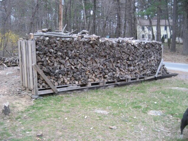

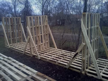

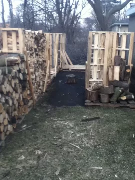

    I copied pallet petes method, pallets are free and a few 2 x 4's and some screws and you have racks.
