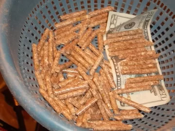

    Dumped them into a clean Englander PVD 25. Had to break up a bunch of longs 3 to 4 inchers. No real big deal.

    Superchips, Are you actually burning 3x more pounds per hour or did you just have to increase your feed rate to compensate for the long pellets feeding a lot slower?

    I'm burning 3 bags a day instead of just one to reach almost the same heat output.
    I broke up the longs by hand, so that wouldn't be much of an issue.
    The pellets burn fully but don't produce heat.
