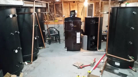

    Self install of the flex fuel is progressing nicely. It's been a great experience this far. The Garn and Flex Fuel were the only units for me. Couldn't fit the Garn, love the flexibility of the flex fuel especially with the high price of pellets in CT if you can even find any.

    Looking at the amount of floor space taken up by the storage tanks and the boiler itself, I'm curious as to what exactly about the Garn wouldn't fit.??

    He probably couldn't get it IN.

    LOLOLOL could never get the Garn inside and even if I could didn't have the ceiling clearance in the boiler room. Was able to fit the flex fuel wood pellet boiler, the pellet hopper which holds 320 lbs of pellets, four 220 gallon water storage tanks and 2 twenty gallon expansion tanks all in the boiler room and all through a 36 inch doorway with the door removed for a couple hours.

    I hear you. A Garn will not go through a 36" door without a visit to the crusher at the scrap yard first......;)
