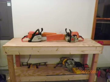

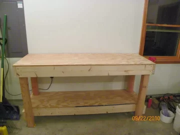

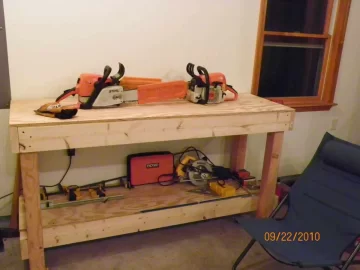

    Finally ripped the 3/4 inch plywood for the top and the bottom shelve, once we moved it to the spot in the pictures I had to shim the front left about 1/8.
    The area which I built it on it was fine.

    that looks great. always nice to have a bench to work at. pete

    Thanks heatwise, I just have to decide if I'm going with pegboard or small shelves on the wall plus a small bench vise on the workbench.

    Zap, that looks great. Room on both sides of the bench will come in handy. I think I see an electrical outlet under the bench, left side. Notch the back of the table for the cable for a surge protected, power strip (4-6 plug-ins). 1 shelf about 6-8" above bench top- full length of bench. Multi-tiered shelving on both sides of bench, you determine the height. Peg-board in the middle 2/3rds. GOOD vise in the corner of your choosing, don't waste money on the H.F. stuff, spend more than you figured on the vise and don't look back. I have nothing else, just that what you built looks really nice so far.- (power-strip, maybey find a square, 4 outlet one, keep the shelf height reasonable). In my head, that all looks great.

    Beetle's right--but make sure you mount the heavy-duty power strip on the front of the bench so there's no need to bend over your workspace and you can access the plugs from the floor without ducking in. Also, you may wish to check out Craigslist for vices. Last week, there were two pristine Wiltons--I'd take a 20-year old W over anything new. Hell, I was psyched to receive one handed down from my dad. I sometimes think about refinishing it, but I like the classic 50's look.
    The only thing I don't see is where you left a lip to attach clamps.

    The only thing I don't see is where you left a lip to attach clamps. Built it without any lip.

    I put thin hardboard ( the stuff used on floors before you put down linoleum) because it doesn't absorb oil quite as fast and soft ply tears up rather easy.
    Figured it would be easier to replace every 5 years or so.
    Still have the original stuff on there 35 years later.
