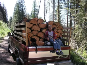

    I'm running a 1986 F250 with a 460 (7.5L) gas engine and the C6 transmission and couldn't be happier. Because I'm in the PNW they use no salt on the roads in most places so there is very little rust on the truck. My take on trucks that are light use is to go with a gas motor because of potential repair costs and because diesels usually cost a premium. You typically won't make back the money you save on fuel if you're only driving a couple thousand miles a year or less.
