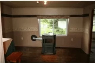

    I came across this picture in a real estate guide.....I am trying to understand the installer's (or owner's) thinking in the choice of location.....any Ideas? To me it seems to be the place where I'd have done a corner install!! I know my wife would say..." how do you put curtains on that window? "

    sorry..thought I clicked preview post...its there now!!

    I'm betting there's at least 3 90º's in the venting! So no I wouldn't install like that even with 4" vent. Corner install would be more appropriate IMHO!

    well, the location for the stove isnt ideal, centered in front of the window....if the customer insists on this placement, you either do this (pictured), or go through the wall below the window and have a good-sized riser outside to satisfy clearances.....if I had my druthers, I'd have to stove at a 45 degree andgle in the corner, but we cant see the house layout from the pic....
    I guess I would do my best to talk the customer out of this, as it isnt great looking for sure, but, heck, if the horizontal run is less than 4', and the clearance outside follows what reccommended by the manufacturer, I cant see an issue.

    Wish we had a bigger picture. It almost looks like it's PhotoShopped in there. No hearth pad? Ugly as hell. Not even centered in window. Why?

    wonder what the pipe looks like on the outside being that close to the window

    I think you guys missed the point ... In the picture.. it is centered! It's centered to the room not the window
    Look closely and u can see that the window isn't centered bit the stove is..Lmao a very weird install indeed and I would have opted for a corner myself

    Well... If it HAD an OAK (doesn't look like it). It would be pretty close to the 18" recommended for Harmans with an OAK (it is an Advance, right?). I know its not 18" and thats the Worst spot Ever for a Pellet Stove..
    But.... If they went out the wall a few more inches to the left, it would meet Harmans 18" (if it had an OAK).
    Why take a Pic of a stove that wont Pass Code? Realtor's should know codes better than most?? No??
    Anyways.... Worst install ever! Congratulations to the person who had it installed. You Win!!! (Nothing)
