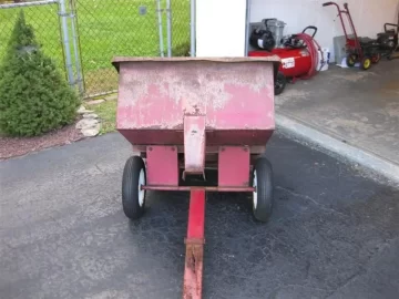

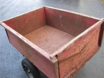

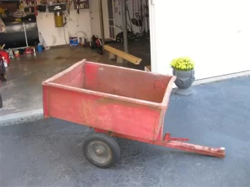

I had an old leaf 5hp leaf blower with a blown engine collecting dust in my shed. I decided to put it up on craigslist on the barter section; I wanted to trade it for a trailer I could tow behind my quad. I figured a regular ol' lawn mower yard cart would work fine. A few weeks later, I gave a guy the blower with the bad engine...he gave me this trailer and $20.
Not exactly a looker, but it was solid.

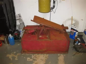

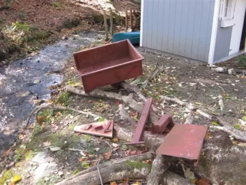

First order of business...the tear down!
I hauled it in pieces up to VT. I started sanding in CT...but my compressor is way underpowered to run a a D/A sander. My electric sander was up in VT.
I made a trip to the hardware store and picked up some new fasteners. The old ones were pretty rusted. Most broke when I used my impact to the remove them.

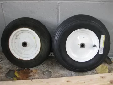

I also picked up some wheel/tire combos from the local Harbor Freight store....with a coupon, $17 each. A local hardware store wanted $18 just for a replacement tire. I brought the axle with me to ensure they new wheels would fit. These are a tad bigger than the stockers and have a built in zerk.

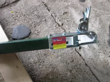

Another HF purchase...the ball coupler. I bought one that fits a 1 7/8" ball and is 3" wide. It just barely fit the trailer. I had to drill one hole to get it to mount with two bolts...pretty easy actually.

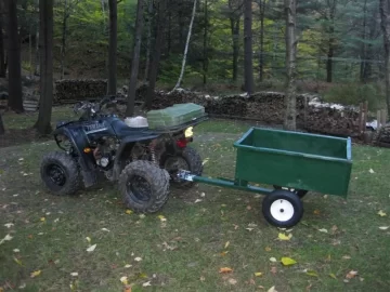

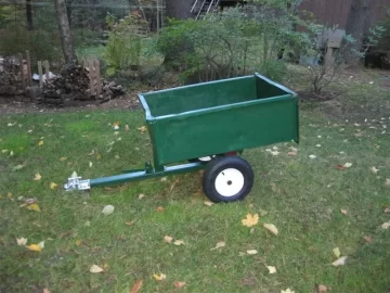

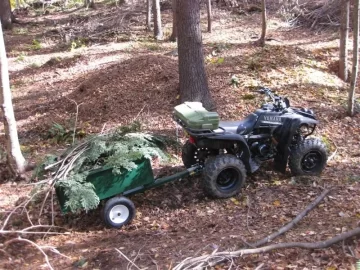

And here's how it came out. A trailer like this will take at least two cans of paint. I was able to extend the mileage of one can of primer, but for paint, you'll probably want 3 cans to be safe. Then again, this is an old trailer, so if it looks good from 20' and the paint keeps the rust at bay, I'm a happy camper. The color is a Hunter Green.
It works great! I was happy that it hooked up fairly level to my quad. It was perfect for hauling around some brush. This should make moving wood around a lot easier. I was using a smaller wheel barrow. I have a feeling I just increased my efficiency by about 508%.
