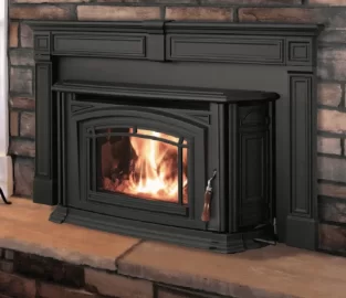

  15. mhrischuk
    mhrischuk
    Guest 2.
    The Enviro is supposed to be real good but I didn't like the battle tank styling and the small firebox. A local stove shop that has been in the business for decades said they are very true to their specs. I went with the Hearthstone Clydesdale. I got the brown enamel. It's really a very high quality unit with best in class support. And it's beautiful! I particularly like the soapstone firebrick and the huge unobstructed glass door.
    Stove $3300 delivered.
    Insulated liner $457 shipped.
    I did the install.
    [​IMG]
    [​IMG]
    [​IMG]
    [​IMG]
    [​IMG]
  16. begreen

    The Kodiak is their plain base model, but the Boston is a real beauty. Even my fussy wife could handle having one in the living room.

    Beautiful! I really like the Clydesdale; however, up here in Canada we don't get the same sort of pricing. For the base level Clydesdale installed is $6,400 while the T would be just over $5,000. Plus I would need the Clydesdale mantle shield and this is very ugly as it attaches to the mantle.
    Thanks for posting, again, great unit.

    Enviro 1700 has the same size firebox as the Clydesdale. Clydesdale=2.4, 1700=2.5. Clydesdale is wider, 1700 is deeper, if I remember correctly. Maybe your thinking of the Enviro 1200. Battle tank styling rocks too. Perfect for my game room install. Something ornate would look too out of place. Different strokes and whatnot.

    That's a nice looking insert.
