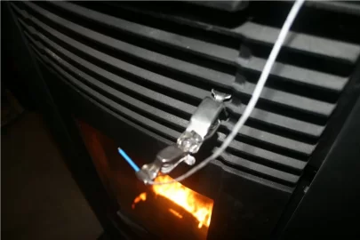

    jtakeman, where exactly do you measure your temps? 6" out from the air outlet, inside the stove, etc? I just have a simple 6" meat thermometer clipped to the air vent in the center air outlet hole, so in actuality it measures temp 4-5 inches inside the stove. According to the specs I found, mine is a 200cfm blower (on setting 9 of 9 I would assume).

    I measure about 3" away(out from) the heat exchanger. I got a picture somewhere.
    SmokeyTheBear,
    I know what your saying(I just wanted the right number out there). It will be another variable that has to be delt with. If I had a smaller fan I would say my temps would be much higher and Much lower with a larger fan with more air circulated.
    By the way. If I need more CFM's. I can steal a blower from my sister stove(the maxx) it has a 455 CFM fan. Maybe you have a sister stove that has a larger fan and you can borrow it for yours?
