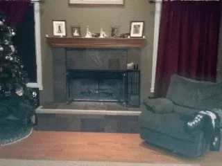

    hello and thank all of you for your time and valuable advice. i am looking for some help on my heating needs. as of now i have an inexpensive big box store fireplace, no damper, no blower, essentially a hole to make fire in which i do and it puts off minimal heat and plenty of ambiance. i want to switch the ambiance with actual heat. i have been doing some research and have been looking at the Supreme Plus. i want to go with a a zero clearance because we really like the look of what we have now its basically what sold us on the house. the measurements are mantle to fireplace 15 1/2", height of fireplace 24 1/4", width 42 1/2" and depth 17 1/4" flu size from what i can measure is 6". i guess my questions are can i make it work and still keep the look i have now, and what do you think it would cost. we have propane heat now and even with the high efficiency set up it is still ridiculous the amount of money we spend on it every year. i have done the numbers and the savings would be great with a high efficiency fireplace. all number crunching and what is most economical aside, we love everything about having fires in the fireplace. guessing this will cost about 5k but really not sure. i appreciate all of your opinions and advice.

    Are you wanting to put a wood burner in that space?
    At 5k your probably correct if you going to have your dealer install. I went to my dealer and they offered to come out and look at my factory Zero firebox for free and nothing they sold would fit. He also said the lennox and lopi's are some of the tightest fitting units out there.
    As for your flue ID of 6", that seems small, most stove/insert’s are 6" flue but that's ID of class A.
    I recommend you find a dealer and have them come by for a free estimate.

    yes it would definitely be a wood burner and thanks for the advice, i have done some more research and visited some local dealers. i cannot seem to find any local supreme dealers but have seen alot of nice units. 2 units i seem to be leaning towards are the Northstar and the Fireplace Xtrordiniar 44 Elite. i have come to the realization that no matter what, there will be some demo to get a unit in. we have a 2800 square foot house and i plan on using this as a primary heat source, so the 44 is looking pretty good. i am figuring cost will go up some but i would much rather spend it on quality unit than give it to the propane man. if anybody has other suggestions or opinions on these models or any others please share, i have no problems spending hours at the fireplace store researching.

    Hello nick01,
    First do some measuring to determine the depth of the hole avaible to install a new zero-clearance EPA fireplace. Pretend that you just ripped that inefficient builder box fireplace out of there. What is the depth of the hole (from the front surface (your wall) to the framing behind the fireplace).
    Here are some zero-clearance, high efficiency (EPA certified) fireplaces you should consider:
    (Note: Lennox own Security Chimneys (BIS fireplaces))
    Lennox Villa Vista (sames as BIS Panorama) This is a CAT (catalytic) unit.
    Lennox Brentwood (same as BIS Ultima)
    Lennox Solana (more basic unit, less expensive)
    Lennox Ladera - same as BIS Nova (more basic unit, less expensive)
    BIS Tradition (not sure if there is a corresponding Lennox branded unit)
    BIS Tradition CE (not sure if there is a corresponding Lennox branded unit)
    BIS Ultra (not sure if there is a corresponding Lennox branded unit)
    Kozy Heat Z42
    Osburn Stratford
    Napoleon NZ26
    Quadrafire 7100 - same as the Heat & Glo Northstar
    Fireplace Extrordinair 36 or 44 Elite. These are CAT units.
    Supreme Zero Clearance (www.supremem.com)
    RSF Opel 2, 3, Delta 2, Topaz, Onyx 2, Oracle (see through unit) fireplaces
    I was in the same situation as you. After ripping out my old piece of crap Majestic builder box fireplace I had a 24 inch deep hole in which to install a Zero clearance EPA fireplace. I then eliminated all fireplaces deeper than 24" from the above list. I wanted a fireplace with a firebox larger than 2.0 cubic feet because I feel 2.0 cubic foot or smaller firebox is too small. So I eliminated all fireplaces with 2.0 cubic foot or smaller fireboxes from the above list.
    Ultimately I ended up with the Osburn Stratford. It has a 2.5 cubic foot firebox. I really like it & it worked out great.
    You should also consider the KozyHeat Z42 if you can accomodate its greater depth than the Osburn.
    Both the Osburn Stratford and KozyHeat Z42 are reasonably priced & good quality. They represent good value in my opinion.
    The Quadrafire 7100 (Northstar) & Fireplace Xtronodinairs appear to be good quality but are quite expensive. They will blow your $5000 budget.
    Your actual choices of zero clearance, EPA fireplaces will depend on what your local Hearth dealers carry or how far you want to drive.
    Plan on having to replace your chimney. I highly doubt your existing chimney pipe will be compatible with the type required for an high efficiency EPA certified fireplace. . Most builder box fireplaces use 10 inch chimney pipe due to their inefficiency - they need big pipe to transport all that heat outdoors! My builder box fireplace chimney was 10 inch. I had to replace it with 6" of the type recommended by Osburn for the Osburn Stratford fireplace. You MUST use the chimney pipe model as recommended by the manfacturer of the fireplace.
    Good luck!
