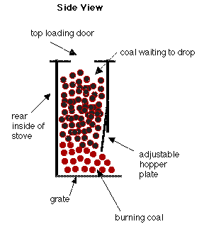

The drawing on the left shows an inside view of a typical hopper-fed coal stove. Coal is loaded into the top of the stove and, once the stove is going well, should be kept full or nearly full. Because of the air flow design only the coal in the lower part of the firebox will burn.When this coal burns completely and turns to ash, new coal will take its place, helped along by your raking/shaking of the grates.
(efel type shown at left. Surdiac and Vermont Castings use a center-fed hopper - operation is similar)
