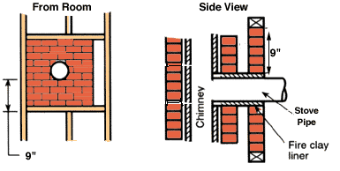

Most older chimneys use a "crock" , which is simply a piece of round terra cotta tile (similar to your chimney liner) which is cemented into the wall. The material that this crock is made from has little or no insulation value, which means the heat from the stovepipe is passed through to adjacent wall materials such as 2x4's, paneling and the kraft paper on wall insulation. Our installation crew has found wood studs as close as 2" away from this crock - many times they are charred! The only reason that the wall didn't catch fire yet is the lack of oxygen into the wall cavity to support the fire - not the type of close call that most homeowners welcome. If you do intend to use a terra cotta crock as your wall pass-thru, then follow the guidelines below.
These requirements have been specified by the NFPA (National Fire Protection Association) , and are accepted by most code officials.

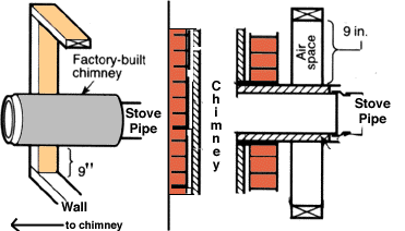

An alternate method is also mentioned in the NFPA guide. See the drawing below:
In this case, a section of insulated, double wall chimney is used instead of the crock...and an airspace is used around it instead of the solid brick wall patch.
