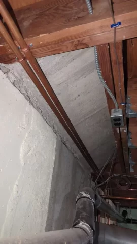

As fall starts to settle in, my wife's decided that she wants to address our living room. Currently the far side wall is about 25' long end to end, and in the middle of it is our fireplace. See pic, attached, with some basic dimensions of the fireplace. The picture might look a bit 'fisheyed' from the lense, but it's 67" wide from ceiling down to the hearth to the floor, and 96" tall (8ft ceilings).
