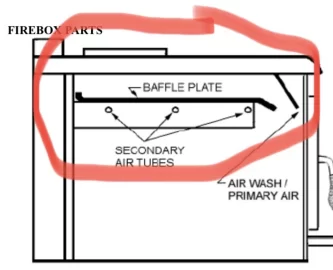

First post here, getting ready to start burning wood and I noticed my baffle is starting to look rough. I have an Earthstove 2800HT and found they stopped making the baffle in 2016 and can’t find a replacement one. The only information I’ve found is that’s it’s 3/8’s thick. My question is what’s the best type of metal to try to use to replace it, I want to say the original one is cast but I’m honestly not sure. The stove is otherwise in great condition and works well, so I’d like to fix this piece instead of buying a newer stove. Any help pointing me in the right direction would be greatly appreciated, thank you.
