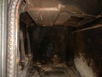

Is this a good deal? The guy has it in storage. It is an hour and a half drive from my house. Pictures look good. Could I talk him down?

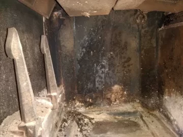

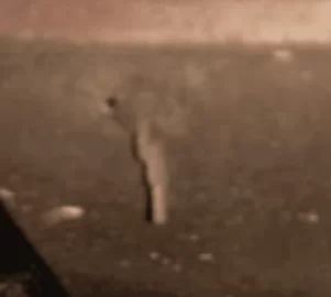

Is that a big puncture/gouge behind the cat, or a spot of soot and a spiderweb?
That's where one of the mounting stud comes through the combustor scoop, and the "spider web" is the clip pin that holds the scoop up. You can see the far one better in the second pic. Check the bypass frame for warping, which would be a sign of over-firing, but it would have to be extreme. You might play dumb and ask him to describe in detail how he starts a new load and gets the stove cruising once it is up to temp. Ask what air settings he uses to burn in the load..'4' is wide open air and I never have run my stoves for long there, I was cutting air to 3 or less almost immediately. Now, his air settings may be a bit higher if he was running it on a short stack, like 13'. My Woodstocks were/are run on 16', rear-vented. I want lively flame in the box, not a blast furnace pouring heat into the bypass frame and the liner. I think roaring fires are harder on the seam cement and may loosen it, causing air leaks. Carefully look at the seams..air leaks will show as a light-colored area running along side of the cement.I can see it as a puncture and a crack, or a spot of dirt and a dangling spiderweb. The picture isn't good enough to be sure about either one.
