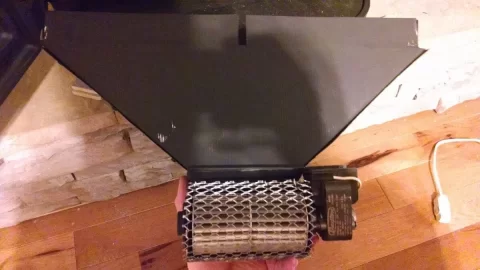

Thank you for your response. This is a pic I had on my computer at work -- it shows the squirrel box on the right hand side of the woodstove.

Still have not been able to get this fixed. I'm attaching some pictures, along with some measurements. the picture above shows where the squirrel cage was mounted -- on the right side of the woodstove and lower than the handle for the damper. The cage measures 11 x 12. The motor is 3.5 x 3.5 round. I have attached some pics of the motor model number and tag from the motor. Any help would be appreciated. 1983 Motor Replacement... 1983 Motor Replacement... 1983 Motor Replacement... 1983 Motor Replacement... 1983 Motor Replacement... 1983 Motor Replacement... 1983 Motor Replacement...

Still have not been able to get this fixed. the squirrel cage was mounted on the right side of the woodstove and lower than the handle for the damper. The cage measures 11 x 12. The motor is 3.5 x 3.5 round. I have attached some pics of the motor model number and tag from the motor. Any help would be appreciated.
