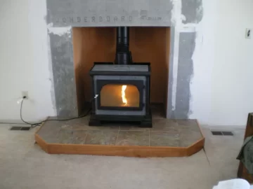

1st break in fire in Hearthstone Homestead.
Dakotas Dad
Mar 19, 2009
1,516
Central Kentucky

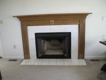

OK, so we went from fireplace to wood stove...
to get the full story (in pictures) of how it has gone so far.. see our album here.. http://tinyurl.com/ylye7l5
we welcome all questions, comments, etc..

So I'm going through your photos and the hearth is square out front and then all of the sudden, the corners are cut at 45s. What happened? I wish I had done the 45s.
How did you like working with the metal studs? I hated them.
Well, one night we looked at it, and thought about the fact that just to the left of that big old hearth is a door we take two Golden's out 20 times a day, and sooner or later we would kick the thing and break a toe... so 10'oclock at night we got the shop vac and saw out, cut the laminated concrete board off, then the next morning, dremeled the steel studs out and added back in some wood 2x4 corners. was easy as pie.
The metal studs are something I think it will take a few times with to get sorted out. I am a school trained carpenter and cabinet maker, so the lay out and all that was no big deal, but the demensions, and flexibility of the steel stuff baffled me a few times. It didn't help that we were trying to work to the footprint of the original fireplace install, and it was not as centered as I would have liked. Truthfully, the "hardest" part so far was the fact that I felt I *had* to have the rock wool batting for insulation under the stove. I don't know how it is in the rest of the country, but that stuff is rare as hen's teeth in central Kentucky.

I would like to cut the corners of my square hearth but then I would worry that the two layers of durock (just like yours) would not be attached to the new corner studs and might lift off.
What made you think you needed rock wool? The owner's manual for your stove allows dead air space which gives a very high R-value. I didn't fill my stud cavity with anything. I should have left a treasure in there like a beer bottle.

I just cut 2x's to fit, and screwed them down to the subfloor with pocket holes, then drove the same type screws down thru the two layers into the 2x's.
For my install, I needed a min. r value of 6.6, so I needed a lot of insulation, the manual does allow "air gap" but only in 1/8th inch increaments, and they cannot be "stacked" so to build up my r value I would have had to figure out how to get multiple 1/8th air gaps.. seperated by "something". I decided I didn't want to even try to figure that out. I wanted rock wool because it is listed in the manual, and has an r value of 3.1 something per inch.. so 3.5 inches gives me tons of non-combustible insulation. After talking with the county inspector, he told me regular unfaced fiberglass bat was fine.. I don't need an inspection, he is a buddy.

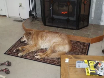

Dakota says he does not know what "HeatLife" is.. but he likes it!

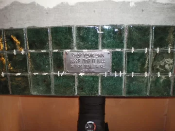

Ok, tile work around the faux firebox is up.. it looks fantastic in person.. out to the shop I go to start on the mantel..

That's a great custom tile. How did you prevent the tiles from sliding off the face while the thinset was wet? I see you back buttered each tile, ugh, that must have been tedious.
Tedious.. yes, but easier then trying to carefully mud the wall exactly where the tile needed to go, then set them.. There is a steel lintel piece that I made that runs all the way around the "firebox".. gives the tile a finished edge, and I was able to just let the top runs rest on it.. other then that it's just the spacers and the thinset.
BTW, I decided on the lintel edge look after I discovered that as expensive as buying reproduction arts and crafts tile can be, buying bullnose reproduction arts and crafts tiles will give a healthy man a heart attack. The green field tiles were about $3 a tile.. bullnose tiles were 3.5 times that, and we would have needed 33 tiles.. we actually wanted to go three wide on the sides also, but were two tiles short of whats in a box to do it, and I wasn't going to buy a whole 'nother 12sqft box of custom tiles at $27 a square foot + shipping, for two tiles.
The chop wood tile was $75 by itself, and there are two more reproduction tiles that will go into the mantel itself, that were even more..
