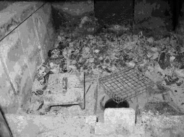

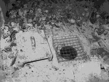

As has been posted on hearth.com many times, ash cleanout on the 30-NC leaves something to be desired. The various methods described on the forum created too much fly ash to suit me so I started to think about other ideas. I have attached two pictures of my solution which is to put a screen in place while raking ash so that only the light ash falls to the pan and the working coals stay in the stove. I get virtually no fly ash into the house using this method. This is only a working model made from 1/2 " hardware cloth / screen. I doubt the working model will stand up to repeated heat application but I have used this about 10 times and its still pretty much together. After burning for two days I generally get a little less than one pan full of fine ash. I just thought I'd pass this along and maybe others have refinement ideas.
