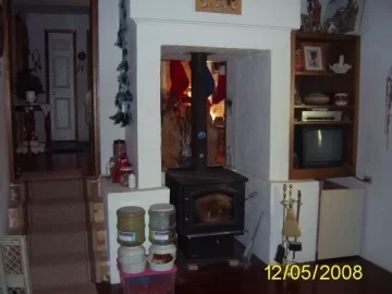

    Alright guys help me out for a friend.
    He is using this stove and is getting pretty short burn times. I asked about NS vs EW burns and he is getting shorter burns with EW. What can anyone say that I can send to him for a bit of help. What have you found that works. I'm talking about burn controls as well as wood.
    His stove is getting to about 600 in about 1 hour, but is down to about 200 4 hours after. Is this usual?
    Thanks for any help.

    It could be the size of the splits he is using or the wood is extremely dry or he is mixing in softwood or lumber scraps. 10 small splits will ignite and burn up faster than 3 big ones.
    Another possibility could be that he has very strong draft and needs to cut it down. Can you describe the wood he is burning and the height of the flue off the stove?

    I'm thinking the second. He puts very small size splits in it. I'll have to see what he can get out of it with larger splits. I'd guess about 20 feet of pipe total.
