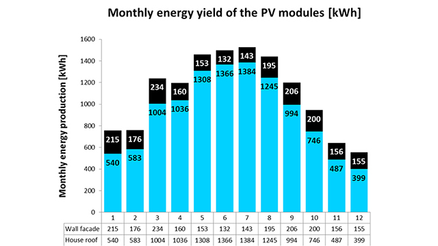

    OK, looking through the site I managed to find a generation graph. Total annual generation is 13,217 kWh. Throwing data for the nearest city I can find at the same latitude (Graz, Austria) suggests they've fitted at least a 15kW solar array (15kW would give that generation at the optimum angle - suggesting they're more like 20kW).
    To take a well-known and (relatively) easily achieved standard for comparison, Passivhauses are limited to 120kWh/m2/year for all forms of energy. Taking the "produces twice the amount of energy it consumes" as accurate, annual consumption is 6,610 kWh. At 120kWh/m2, that gives 55m2 or more internal space to meet the standard. To me, it looks smaller than that - at a guess about 35m2, but I'm struggling to get a good estimate. That sort of fits - they mention 24cm (10") of blown cellulose, which sounds a bit thin to me.
    In other words, it isn't bad but has achieved most of it by fitting a giant PV array. The design is quite nice, and does the world a service by showing that you don't need to live in a cave to have a low-energy house, but it doesn't seem to advance the technology very much.

    The ceiling is, so far as I can work out, just a repackaged swamp cooler (well, probably - their website is awful). And I'm definitely not a fan of the way they've done the PV - they designed the house first, stuffed a load of insulation in and fitted triple glazing, and then covered every available surface with PV panels to make it generate more than it uses. Look at the generation graph - the vertical wall really isn't doing them any significant amount of good in winter. It's eco-bling. Similarly, the roof panels would give them a lot more with any amount of slope. As it is, they're going to have big problems with snow in winter and probably dust/bird lime in the rest of the year since the rain really won't wash them off.
