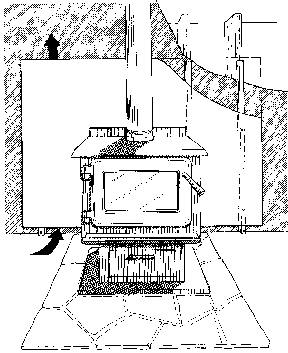

Here's what we have for regulations on wall mounted heat shielding in Canada. http://woodheat.org/clearances.html
The important thing to note is that the shielding needs an open air space above and below the shielding, as well as behind it, to allow plenty of air flow. So in other words, even if you build a brick wall with an 1" air space behind it between the bricks and the wall it wouldn't meet regulations here because there would be no air flow space at the bottom of the brick wall to allow the air to flow under.
Note the arrows in the diagram indicating airflow.

quite correct, the way a properly done wall protector works is similar to a chimney , remember Boyles law concerning a "rising column of air"
the stove heats the shield which heats the air behind it, this air wants to then rise as its warmer than the surrounding air. this is allowed as the top is open allowing the warm air to escape into the room. the resulting vacuum of the air leaving "draws' colder air from near the floor into the open bottom of the shield thus you remove heat by circulating air through using naturally occurring convection to move it. and the wall behind the shield remains cooler as this heat is prevented from radiating through to the wall surface.
a solid wall with no convective air space would simply allow the heat to permeate through the bricks to the wall behind it.
