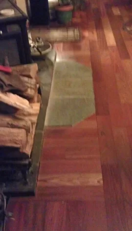

This stove just fit under the brick. It is 28" wide and has a 15" tall loading door on the left side, bottom hinged, so stove is turned part way into fireplace to accommodate the door and the extra clearance to combustibles needed. It's rear vented (like a corner install) into a 15 foot insulated stainless chimney liner and has a stainless block off plate installed. A shout out to forum member bhollar who did the install and added the bluestone ember protection (that I must still stain and seal) flush to the wood floor.
