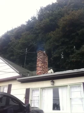

How is the stove vented? Is this 20 ft straight up or is this an exterior flue that has a T and thimble that the stove ties into? It might be chimney location is compounding the problem. Can you post a picture of the exterior part of the chimney?

Direct vent SS flex liner.. Don't mind the massive antenna in the background
Doh, missed that this was an insert. Seems like that should work ok, unless the tree barrier behind the house is causing squirrely wind currents. What direction are we looking in the exterior shot? North?
South, ish. We usually get west wind blowing right up the Columbia. I could throw a rock and hit your state ;)

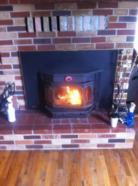

Typical QF 4100i burn picture...door cracked open for air.
