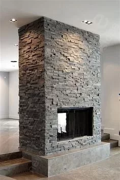

Hi, I've just bought a 1960s house with a Baxi Burnall fireplace. I've removed the dated sandstone fire surround which went from wall to wall across the room but intend to keep the open fire and install a more modern looking fire surround.
Maybe a split stone veneer, floor to ceiling... something like this (but against the wall): Advice on building a fire surround/ false chimney breast
I'd want to build this out from the wall for both visual effect and also to minimise smoke entering the room. Currently, the fire opening is flush with the wall The question is what materials should be used to build the framework? I've seen a build on line which had timber 2x4 studwork with what looked like cement backing board and the stone veneer on top. I'd be concerned about using timber framing especially around the opening of the fire, even though it would be covered with cement board and stone veneer?
Any thoughts on this? What alternative materials could be used to create the false chimney breast?
