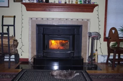

    Here's mine :)
    I run the fan on high most times because I think it kicks out more heat, esp. when it's in the single digits outside.

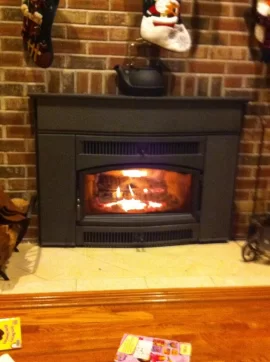

    How about lopi cape cod? Steel stove and cast iron surround or even a hybrid fyre. I am just trying to stick up for my stove since it's not that popular. Here is a pic of mine

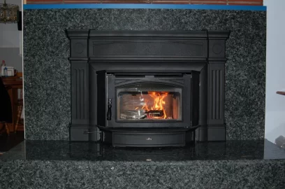

    I have the Hampton HI300, second year with it and really like it. I run it with the fan on hi most of the time. this unit looks good and throws a ton of heat.
