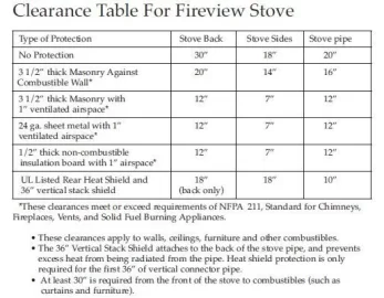

I have a Woodstock fireview ready to install and I am almost finished with my hearth. I am looking at about 18 inches clearance from the rear of the stove to my wall. I installed cement board on sheetrock and then put stone on top of that. My question is I was originally going to leave an airspace behind the cement board but I had a well respected chimney sweep come out to give me a installation estimate and they said I didn't need it and that going directly against the sheetrock with my setup would be fine. Just wondering is this safe, its a little late on the airspace being I'm almost done but I can get rear heat sheild for stove and pipe if necessary, any thoughts?
