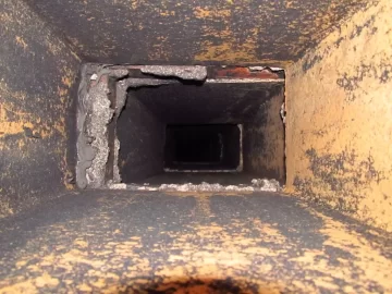

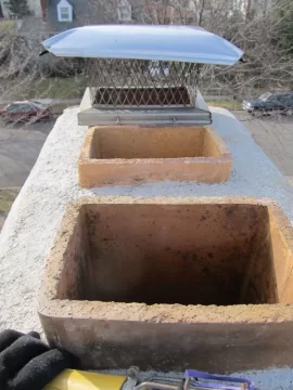

    With a flue like the following, does a rigid SS oval liner make good sense? Can it reasonably be insulated with something other than pour? (Do rigid liners have 316ti on the inside?)
    · ceramic flue w/ inside measurement of 6.7” x 10.7” (or so)
    · 19’ from damper to top of flue.
    · top of 3-flue chimney is outside the house for 7’ on one side and 12’ on other
    · flue for this fireplace is in center. One other flue is exhaust for house’s primary heat—gas furnace (and was warm today!)
    · There are “concrete snots” [I learned that here!], but not much “offset”
    · 26-yr veteran fireman-now-chimney-repairman& sweep assures that flue is fine for burning
    · NFI-certified potential installers are willing to knock out some masonry, so damper size is not an issue.
    Goal: install an Osburn 2200i w/ 6”-equivalent (rigid or smooth inside dual-ply flex?) liner with *some* insulation
    Pix attached! (video TOO large!)

    Yes, if you oval it you can use wrap insulation.
    No, they are 316L or 304L. 304L is for wood only, anything else requires 316.
    Obviously depending if rigid can fit, depending on the offsets, why not use round rigid and 1/4" wrap insulation?
  3. begreen Super Moderator
    joined: Nov 18, 2005
    36,457 posts
    South Puget Sound, WA
    Or go with Duraliner. It's preinsulated, no need to ovalize. Comes in rigid and flex. It's good stuff.
