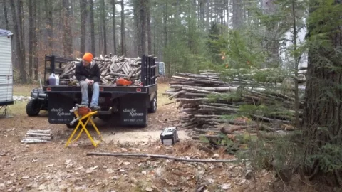

YOu mean like this?
Anyone have a jig set up to quickly recut wood thats too long?
or this?
Yeah. Only I had the idea to have the motor on the opposite side and have a long handle going across the jig to the other side where I was standing, and having an electric foot pedal for safety
I didnt know they made them for sale
