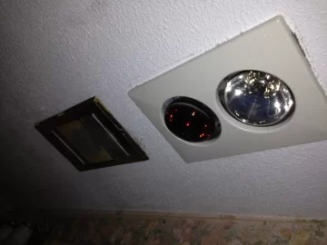

I put in a Sun Lamp & Heat Lamp combo with squirrel cage exhaust blower. The squirrel cage exhaust blower works well for venting. The vent goes thru flex aluminum to the end of the house for proper exhausting. Exhausting to the soffits is a big NO-NO ! Then I put in a reversible fan with a heating coil behind it. When it blows down the coil heats to blow warm air. That works well. It also blows up for exhausting to the outside.

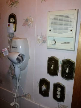

I could not decide to put these on a timer or have full manual operation so I put in a toggle to select either timer or manual. Any combo of lights or fans can be put on the timer and they will all shut off automatically. Nice to have next to the wall hair drier when getting out of the whirlpool! :)
Above the controls is the house intercom of course!

  • Anyone have bathroom exhaust fan with a heater?
I could not decide to put these on a timer or have full manual operation so I put in a toggle to select either timer or manual. Any combo of lights or fans can be put on the timer and they will all shut off automatically. Above the controls is the house intercom of course!
Holy switch bank, Batman! "Naked unit to Houston, initiating shower sequence in T-minus..."
A timer with a hold function wouldn't suffice?
Is this in the shed? :p ;)
