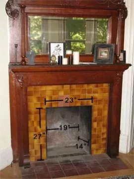

Im looking to see if anyone knows of a pellet stove manufacturer who makes a insert to fit into a 27" high x 23" wide x 14" deep fireplace opening? To make matters worse, the 23" width opening narrows down to 19" wide in the back.
I know, I know. It's a *tiny* fireplace opening and Im having a heck of a time finding a pellet insert to fit it, but it's the only fireplace I've got inside a 1860 built home.
Would anyone know of any manufacturers that might make something to fit in there? I have called every stove store within 100 miles and have had no luck at all so far. I am trying to include a pict of the fireplace with dimensions. ( hopefully it will upload ok, as I don't see it in the post preview)
Thanks for any pointers, leads, suggestions, etc.
Jill

Thanks for the reply Elk.....
.....Hmmm, though. The specs on that Newport Bay model from Avalon are:
Min. Fireplace Size --30" Wide X 19 5/8" High X 16 5/8" Deep
(www.avalonstoves.com/specPages/5.html)
My opening is only 23" wide x 27" high x 14 deep. So it looks liks a 'negatory' on that model.
Anything else you can think of that might squeeze in there?

Again, from my totally 'untrained stove & fireplace terms reading' of the specs, it looks like that FP unit will also not fit properly into my fireplace opening either. My actual opening size is ---> 23” wide x 27” high x 14 deep. Narrowing to only 19" wide at the back.
I can now totally understand why the sales people at 4 different area stove stores have said they don't have a pellet insert that will fit my fireplace. As I'm reading over the specs on the two models both you and Elk mentioned in this thread, it certainly looks like neither will fit.

Yeppers. You are correct. The fireplace is a pretty shallow Rumford design, probably built around 1855-1860. It angles in pretty sharply on the sides. It also has a somewhat thin, ornate metal covering over the bricks inside the opening that I could probably remove to squeeze and extra 1/2 inch of I.D. space if I needed to.
Seems to be quite the biaotch to find an insert for, as Im learning rather quickly.

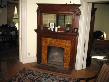

You can't tell very well from the pict in my OP, but the fireplace there is built at a 45 degree angle in the corner of a smallish room with 2 double width doorways immediately on both sides of the hearth. The fireplace is also located right dead center of the house where 3 other rooms come together. Any stove/heat source that's not an insert and uses the existing chimney, will then be sitting way out into the room and directly into the most frequently traveled paths through the house. So I would much, much prefer an insert over a freestanding stove like the Thelins....

Tossed in a better pict of the fireplace showing doorways on both sides.
