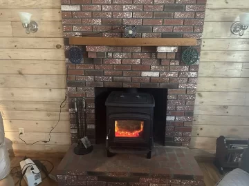

The wires are messy, but I’ve never been good as cable management. I use it 90% of the time and when it get really cold and in need to push my stove. I can lower the stove top temps by at least 50 degrees on medium. I was really glad to have a blower the one time I over fired it.Thanks, I wasn’t even aware these were available.

Thanks for all the replies. I am not at all familiar with these fans. They don’t have to be bolted to the stove? They could just be plugged in and it can sit on the hearth under the stove?I also have the AC infinity air blaze fan. I put it in front of my fireplace. I put it in the cold and it blows the air and wow it’s the best. The best settings are the timer and the fact that you can choose settings from 1-10. And it’s quieter and more energy efficient.
What is the block off plate you are referring to?Yes. I have used two different one. First one was the cheapest quadrafire pellet convection blower. It was ok. Newest one is this air blaze. It’s much better and completely silent 3 ft way as speed 3 or lower.
I have a block off plate. If you don’t you need one. Blower or not.
The fan sit on the floor behind the stove and just blows up.

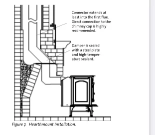

its a plate that air seals the old fireplace firebox around the liner. Keeps hot air from going up the old flue.What is the block off plate you are referring to?
AAAh, thanks. I have a free standing instead of an insert.
