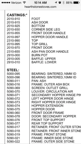

Cleaning the fire box with a damp rag can cause that. Moisture goes right up the auger chute.

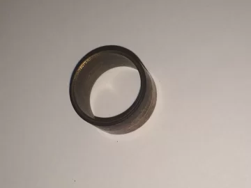

Also a gummy dirty auger bearing can do it.
See sintered bronze bearings in your manual.
I prefer the nylon or nylatron bearings
Pic - 1 Hearthstone pl
Pic - 2 dirty gummy bearing example

Hello
