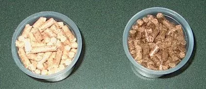

Has anyone else experienced this? And I am wondering what it was about these that made the noise... is it due to the shorter length or the darker color... and what would make the pellets a darker color? Where they over heated when they were manufactured and compressed, or could it just be a different type of wood? They actually do look a little burnt in a way, and feel somewhat harder than the normal lighter colored ones. See the picture below for a sample of each... So far I have only encountered one bag like this... any thoughts?

Looks like softwood on the left & hardwood on the right.
I don't see anything wrong with either one...
I have had some grinding when going from a longer hardwood pellet to a shorter softwood. But it happens occasionally and only for a short time.
I have also noticed it will happen if I grab a bag that has been in cold garage and not allowed to warm up. Again, only the softwood, shorter pellets will do this.
Currently, I bring in the bags and let them sit for at least half a day...no noises.
That's interesting, because the bags say 100% Northern Hardwood Pellets and they are normally all light in color as shown in the cup on the left, which you identify as possible softwood. All I know is that the darker pellets in the cup on the right, which are the same brand, were definitely causing the auger noise. I think it is the shorter length that was the culprit. I am just curious why they are so different than every other bag I've burned so far. I'll probably just mix them in with the good stuff and burn em up! ;-)
