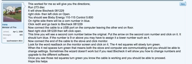

Funny stuff! Up to now I have never been able to get Bixcheck to connect to my burner no matter which computer i try. My computer is a Mac so I usually bring home one from work. Now that I have more Bixby's to experiment with I am going to give it another go. I have two versions of Bixcheck: 80315.com and 81229.com. Are their newer versions? Will bixcheck work on a Win 10 system or do I need to find (if possible) an older version. If I can get communications going I will probably ask what you tweak to get a "lemon" to burn better. It starts and burns but the flame never gets as robust as the other ones. But one thing at a time! BTW I attached some instructions you sent me years ago after i purchased a cable from you. Fun times!
Shoot me a e-mail at [email protected] as I don't usually look at these forums every day.
