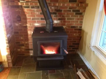

got the call yesterday morning. my stove arrived! took the drive down and picked it up. instrall wasnt too bad. myself and a couple friends(beer helped motivate them) handtrucked the crate to the final resting place. the most diffacult part was plumbing in the stove pipe. whoever built my chimney didnt have the common sence to center the thimble.

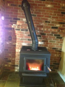

right off the bat i had a poor draft. smoke spilling out into the room when lighting the kindling. after a bit of not so nice words i cchecked the cleanout in the basement. the chimney sweep left the door open and didnt re install the fiberglass insulation i use to make it air tight. seems good to go now.
some kindling and a few small splits and she was up and running. let the cat probe get to about the 11 oclock position the closed the bypass. cat climed till it was almost to the max position with the thermostat set at #3. i knew the stove would be smokey while breaking in but holy XXXX this thingreally smoked up the house even with all the windows open and 2 box fans running. my smoke alarms were going crazy! took a good 2 hours for the smoke to clear off and out.
burned down to coals and threw in a load load at 9 last night. closed bypass and in 5 minute incruments turned the thermostst down from 3 to 1.5
woke up this morning at 6 to a warm 70* house. turned the dial back up to 3 and to my suprise(not really) she took off again and still had 2 3/4 burnt logs and a ton of coals!
sorry about the pic's. cell camera

Congrats. Welcome to the boring Blaze King world. Hope you don't enjoy messing with the stove too much ;)
Nice install.
edit: Moved as to not derail this thread
congrats and hope you enjoy your new princess!

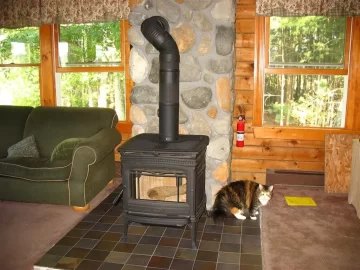

Nice stove and hearth! Personally I would have used the straight pipe on the stove then the 45 and 90 onto that into the chimney. That's how I piped in the stove.. I attached a pic to show what I mean..

Nice stove. I just am so distracted by the problem.
That flue situation you have there would be unacceptable in my home. The pipe isn't even in the collar all the way, is single wall, and you aren't supposed to have a bend right on this stove. It would be better to at least shift the stove to the right and clean up that crazy bend on the stove top so that you get a good engagement at that point.They also sell a single wall slip joint so you could keep the stove centered but get all the pieces to fit properly.
Nice stove, that pipe would drive me crazy too, if you did it the way Ray did it would look better.
Ya I know the pipe is shotty. I'm going to do the correct vertical install with double wall pipe. Thus is jut to get up and running for now. My last install was like rays. Where is a good place to get double wall pipe?
