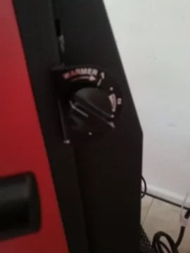

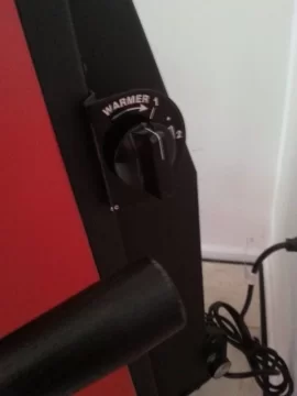

So,I picked up my missing thermostat knob from the dealer yesterday,he said all I need is a small allen wrench to attach it.I have my allen wrench,question is how do I know at what position to tighten it?
The two pictures are my best guess.Showing range of motion as far to the left(l.ow) and as far to the right(up)as it will turn.
Something tells me this is too great a range.
Thoughts?

The range is correct, the position isn't.
I think the thermostat is the same as my Princess. If so, turn it as far as it will go open then put the knob on so it points to 6:00
