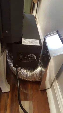

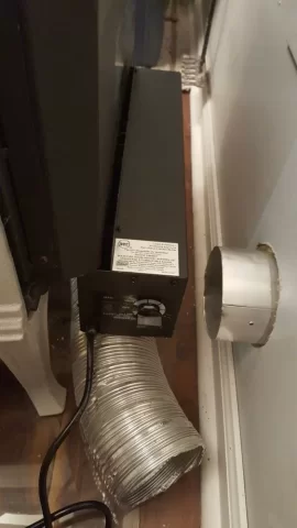

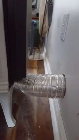

This summer we had our PE Alderlea T5 installed and have really loved it. I recently decided to add the blower. However, the blower does not fit due to the ducting. Can anyone think of a way to squeeze the ducting around the blower? How much can I flatten the ducting without adversely affecting the flow? I'm open to any ideas. I'll swing by the stove shop that did the install next week, too.
