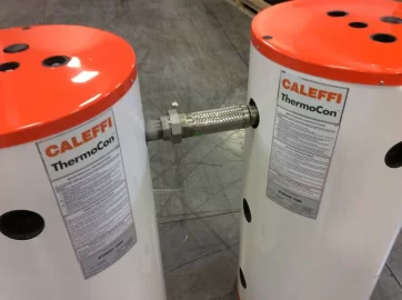

How about corrugated stainless steel tubing? The ones used for flexible water heater connectors have a max temp. rating of 190F but I assume thats because of the EPDM gaskets.
Might replacing the gaskets with something of higher temperature service make them suitable?
I just use truck heater hose from pex to pump connection. Rated for higher than 212 boiling point(which the boiler will never get bear anyway) works awesome. Nice and flexible.
Corrugated stainless is okay, depending on the gaskets. There are certainly ones that do not have EPDM or rubber gaskets that will work.
The ones shown in the first post have gaskets I would be nervous with.

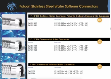

What size do you need? Corrugated stainless is common for solar, which can run 300 plus under stagnation conditions. The tube and compression style fittings get $$ in large diameters.
Falcon Stainless has a selection of boiler connectors in 1-1/4 and 1-1/2"
250° 200psi They do show an EPDM gasket on the swivel ends.
I think they will build most any size and length, these are in their online catalog. I have another source in the south for custom made versions. I had some 2" X 12" with union ends made.
