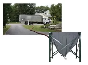

Hello
Wood Pellets in Goffstown NH who provide bulk deliveries to customers are currently working on a generic automatic filling system.
I talked to their sales engineer last year and he said the "future transfer systems" metioned below is code named "Magic Bucket"
Maybe someone can call and see how much more progress they made on that this year??
http://www.woodpellets.com/services/bulk-delivery.aspx
Tired of tearing open plastic bags? Bulk pellets are delivered naked! We deliver them to a storage container in your garage, basement, or outside. You can fill a bucket from the storage container with just the weight you want to carry, and no plastic bag to throw away. Bulk delivery also allows for future transfer systems that will move fuel from your pellet bin to your heating system.
Also Harmon makes a 1400 lb auto feeder for their pellet boiler. That may work for yours also?
Link to Bulk Hopper Brochure
(broken link removed to http://hearthnhome.com/downloads/brochures/BulkHopper.pdf)
