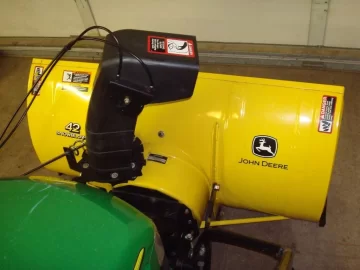

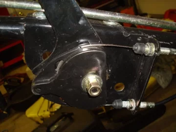

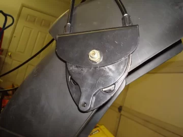

    I run a similar setup here. Looks like you have an adjustable (height) chute - might if you share the details how that is rigged up? I have a manual one - as in get off the machine, angle up/down as needed.
  3. MasterMech Minister of Fire
    joined: Aug 2, 2011
    4,779 posts
    Hudson Valley NY
    Standard equipment on that setup. It's a push/pull cable setup. Simplest way to retrofit yours would be a cable to pull the deflector down and a spring to assist it on the way back up. What specific rig do you have? Deere? Another brand?

    I've got an older Craftsman setup. Any possibility of you posting a closeup of your cable setup?

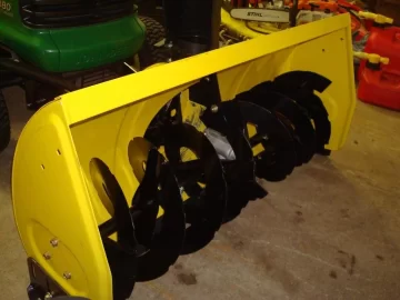

    Craftsman used the same blower (Agri-Fab) I have for a long time. Dunno but they still might. The L100 and LT series is the only set of tractors that Deere didn't use their own design for the snowblower.

    Thanks for the pics, MM.
