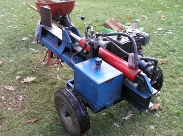

Scored this splitter over the summer for free. All I can tell is the engine is a 1978 by the engine code#. Works fine except cylinder leaks like a pig. Can anyone identify it? Make/ model. Thanks.

Sorry, can't i.d. that one, looks homemade to me. Take the cylinder off and have a reputable shop repair it (probably needs a seal kit). Doesn't matter who made it, just have the cylinder fixed and put her to work!
I agree it looks homemade to me, and good luck having the cylinder worked on. I took a cylinder in to a local yokel years back and he had it for 3 months and come to find out, he never touched it. Said he couldn't find time or parts. Don't remember which.

They'll probably want to hone the piston while they have it apart. It might be cheaper to buy a new one (cylinder), depending.
Yes the splitter is homemade but it looks well built. If you take the cylinder in to be fixed get a firm cost. A replacement only needs to fit in the same location it does not have to be brand specific. I'm quessing the cylinder to have a 4" bore . They can be found new for under $150.00.
Thanks everyone for responding. I acquired this splitter from an older gentleman who replaced this with a new one. I have since found out that he thinks his new splitter certainly is not like his old one. I guess they dont make things today the way they used to! Anyway, does anybody know of a reliable hydraulic supplier on the internet?

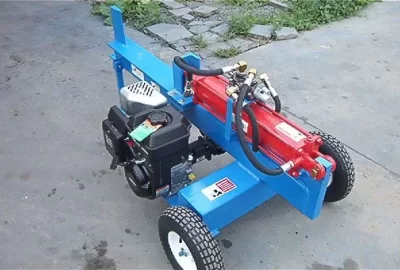

Found this cylinder on E-bay . Good price. May fit. $50.00 + shipping.
HYDRAULIC CYLINDER, USA SURPLUS, 4" X 24"
GREAT REPLACEMENT CYLINDER FOR LOG SPLITTERS Item number: 230206370062
Surplus item 40 for sell.
