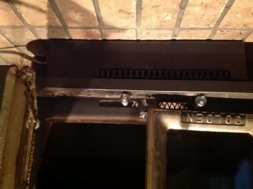

    Hi all, first time posting here. Just moved from Miami to Arkansas and purchased home with this insert and free standing wood stove downstairs. I'd love to find an owners manual if at all possible,anyone ever see one of these? The home is 30 years old and I have no idea when this insert was installed.

    That is an interesting one, I can see that Golden Glow used to make stoves but they are no longer around. If you could pull it out and look at the tag on the back of it that should help, hopefully it still has one. The surround should come off easy. Kind of looks like a Fisher.

    Thnx mellow. There is no tag on the back but the metal inside the door is stamped "golden glow hot springs Ar" as you said they are no longer in business.
    Their are two levers at the bottom, do you think they are both for controlling damper? When opened they reveal a small screened section. Trying to figure out exactly what they are both for.....anyone?

    On the lever question. It is my experience that most stoves/inserts have two air controls. One for starting the fire and one for regulating the rate of burn. The one that is for starting the fire makes lots of oxygen available (my QFire has what we call a shootgun air feed that comes into the back of the firebox at about fire level) and needs to be shut down after the fire is going . The other (my QFire had air tubes running across the top of the firebox with air holes to drop air down on the fire from the top, helping to burn gases coming off of the fire) is used to regulate the burn. Here I am assuming "air tight" type control, that is air tight enough that it is possible to shut a moderate fire down, maybe even put it out, but shutting of the air.

    This is a pre-epa insert, those levers are for controlling your air intake, you should have a damper control somewhere, might be between the stove and surround to open and close the damper on top of the insert exhaust, then again it might not have one, never seen a stove from these guys before.

    For anyone who might be interested, I found out more about my mystery insert after having both of my chimney's swept (the gentleman I called was last here to sweep in 1998!)
    He said its a "knockoff" of a Fisher and the local person who was selling the knockoffs went out of business years ago after being fined for several copyright violations.
    He said both chimneys were in remarkably good condition considering the 15 years between sweepings. He also showed me how to work the controls on the downstairs mystery stove. $270 well spent I suppose
