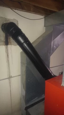

That is the new stove pipe. It was 800 for the cleaning and the stove pipe. I thought it was steep also. But, when messing with fire indoors I trust a professional since I don't have previous experience with wood burning furnaces. Thanks again guys. I'm going to try a small fire later to heat it up and get it running.

I'm not a chimney expert but I feel like something is unusual with that joint before the turn into the wall. It seems like the flange should be on the exterior, not interior. But I could be way off.
I've used 3M high temp tape with some success. It's not a bad idea.
Do you have a cleanout/tee in the back of your furnace? You're going to have ash buildup in this section of chimney. If your guy didn't suggest a tee I'd question his desire to come back out and get more cash later in the season.
