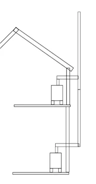

We are exploring several wood stove configurations for a part of the house that isn't served by central heating, a former garage that has been turned into a workshop and a room above it. If two woodstoves are in identical positions one floor apart, one directly above the other, would be they be allowed to share a stack as in the attached diagram?
No
Ray
Franks said:
Its against code for two wood stoves to share the same flue.
Definately not allowed.. think the draft would stink too.
Definetly not. That is why you see chimneys with multiple flu exits; different fireplaces/burners for each one.
