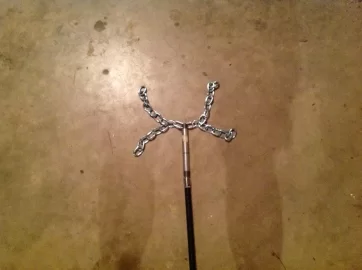

Made a chain flail attachment for my Gardus sooteater for that harder creosote.

For getting medieval on creosote. If that's not their slogan it should be.
Reactions: PapaDave
The old steel pipe its fine in but not clay or stainless. It will ruin stainless and crack and destroy clay.
Pete
I'm just thinking a good, hot fire will do better at getting that 'hard' creosote off instead of using that thing....
Burning properly seasoned wood will prevent one from having that hard creosote to begin with. I've never had that problem in my flues.....
BigDaddy, I'd try building a good, hot fire here in the near future, and letting nature do the rest. In a couple months of humid air and summer heat, most of that creosote will curl up, peel off, and fall down the pipe to the cleanout. I'd shy away from spinning that thing in your flue pipe. Just my opinion.
Neat idea, though. It'd be fun to poke that thing into a hornets nest and let 'er rip (from a GREAT distance, of course...)
I agree but unfortunately there are those chimneys weather inherited with a purchase or just burned wrong that are bad. Our neighbors home when they bought it was so bad you could not put a toothpick through anywhere we used a 2*4 with nails on the end to break out the creosote then rebar and finally my chimney brush. After that they installed a nice insert and have no issue now.

I guarentee he just mutalated the chimney ! This video comes up every now and then personally I think the guy is nuts for running that flail through a clay chimney.
Pete
Just because someone posted a picture on youtube does not make it good.

Big daddy please understand I am not trying to be a jerk ! In steel that would be cool for sure the old pipes are really tuff however stainless is not and bends and cracks fairly easy. In fact the manufacturer of my stainless told me to use a poly brush because metal brushes leave scratches and can wear it out. Putting a flail into clay is like taking a sledge hammer and smashing a cinder block to pieces. Clay is not capable of taking blows like that without cracking. To be honest if a sweep came to my place and said this is how it is done I would say never mind please leave. I would hate to see you smash your chimney or bend your pipes. Growing up around wood stoves and seeing more than a few really stupid ways of cleaning them out has opened my eyes to what to do and what not to do. My parents used to lite the chimney on fire on purpose once a month to clean it out while our neighbors tied a bag of stones to a drill stick ( no joke ) things like that where just common practice back then. Just because a pro says its good does not mean it is the fact is they develop things to make there job faster not safer for your chimney. The more they clean the more they make ! There is only one good sweep by me and he uses a version of the soot eater with plastic whips and it works good so good that I bought one after he let me watch him. It keeps my chimney really clean plus I burn hot so there isn't really buildup to worry about.

I have the soot eater and I have used it but my chimney became blocked and the only way I got it opened up was by dropping a log chain down it a several times.
I read that the chain flail was safe for clay lined chimneys on websites that sell them.
I don't want to damage my liner but I want a way to keep the chimney clean without going up on the roof. Any suggestions .
